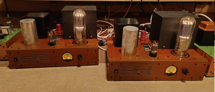

With a slightly better grasp of circuit optimization and help from PJ, this amp (first picture below) came together in just a couple of months in 2019.  With some custom made Sowter parallel feed iron, these monoblocks were awesome!  I really regret selling them, and their current owner is very happy with them!  This was an amplifier that I wanted to make more of, and it used our Kaiju power transformer and just a large 3K parallel feed output transformer and a manageable 30H plate choke.  Power output was right on at 30W with new production tubes, and slightly more with old stock specimens.

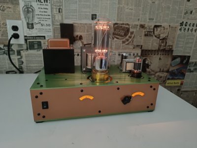

The results of this iteration are shown in the second photo (odd colors chosen help ensure they stay in my listening room).  Power output from new production 805A tubes is 15W at 1% THD, 28W at 5% THD, and 30W at 10% THD.  Power available at 35Hz is only a watt or two lower than these numbers.  Frequency response is -1dB at 16.5Hz and 22.3kHz, and the damping factor is a bit higher than our typical amps at 4.4.
Sound wise, these amps sound large and fast with ample reserve power and a good ability to remain composed through difficult passages.  The higher damping factor is very rare from a high power SET amp, and this leads to tighter bass and better synergy with a wider variety of speakers.

When we listened to these amps recently  (driving the Jaeger speakers), I thought they sounded clean, relaxed, and authoritative at the same time, without losing the warmth of SETs. PB really came up with something special.
I love the color scheme of the second photo amp. What kind of finish is it? A paint or is it the material itself that has that awesome sparkle green? Well done. So are you eventually offering it as a kit?

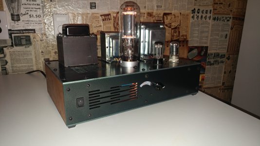

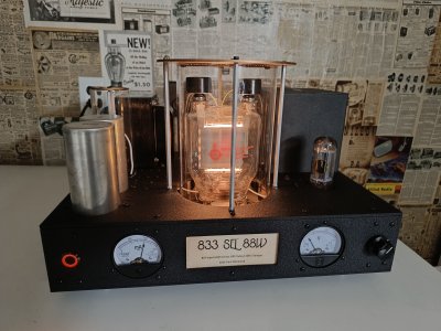

The green finish is a powder coating finish called fractured illusion apple, then the sides, front, and back are a caramel color.  This year I am doing a lot of projects themed in dessert color palettes.  A kit version of this would be squeezed onto a 10"x16" chassis plate which is the same size as the Kaiju and BeePre, though the option to go finished is certainly also possible.
There are other sizes and form factors in a finished product that we can explore which are a complete pain in the butt to offer as a kit, hence the possibility of two products.

Hello Paul, thank you for the generous response, it is very pleasant to know the history of this project that is so loved by everyone, without a doubt the journey of this wonderful amplifier is admirable. Please, if possible, you can offer a version as a KIT, it would be great, since the full version is great but more expensive.
The prototype looks incredible, also the information in the newspapers and magazines on the wall.
