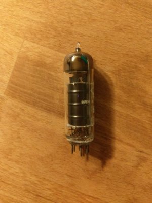

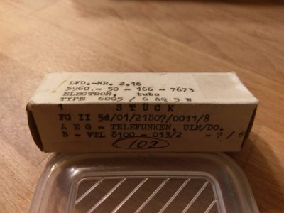

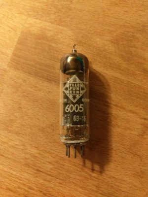

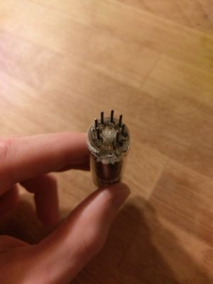

I think I have completed my shunt regulator tube collection for the Crackatwoa, or at least, I don't want for any others.
Introducing the Telefunken 6005, manufactured in Ulm, Deutschland, based on the General Electric 6005.  Internal construction is very similar, although the getter is raised and parallel to the top mica, unlike the GE 6005.  Also, the plate is sectioned only in one place, rolled like a hard-candy wrapper, whereas the GE 6005 plate is sectioned in two places, like two half-circles meeting.
These tubes offer the greatest clarity, space, and bass definition of any shunt regulator tubes I have used in the Crackatwoa.  Listening right now with a Tung Sol 6SN7GT round plate input, MOV A1834 output.  Incredible.

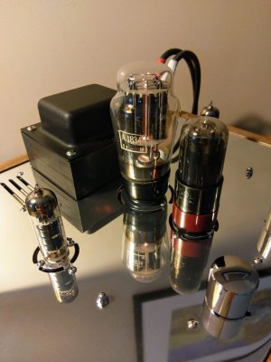

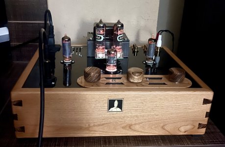

I have been rolling tubes in my C2A and find that I love the GEC A1834/6AS7G. I came across an adapter to run two GEC A2293/CV4079 tubes and got it as a cheap experiment to see how similar it might sound to my all-star favorite.
I measured the voltages before running these tubes and everything is happy except the “OB” measurements on the high current boards are 79.4V and 82.2V; below the recommended range of 90-110V. Is it safe to run these out of range?
