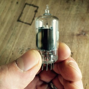

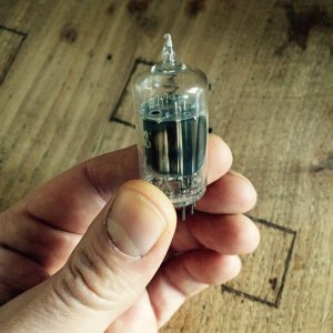

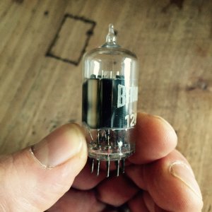

I purchased a Brimar 12AU7 on ebay and got it today.
It has a metallic area on the glass that no other of my 12AU7s has.
Does anybody know what caused this?
Should I try that in the Crack or is it dead?

orson:
Perhaps this Brimar 12AU7 was constructed with a "side getter" and what you are seeing is the remnants of that.  If so, then based on the apparent color of the "stain" on the glass,  the tube should be fine.  Many 6DN7s have this characteristic.
All of your 12AU7's should have this, but it's usually at the top of the glass.
If they don't have this, or if its white, then the tube is suspect.
Noob as I am it took a time to understand.
Quite embarassing.
But now I know for life what a "topgetter" and a "sidegetter" is.
Hope I entertained you a bit with that question.
And to add something useful: I listened the whole evening to the Brimar and must say I like it even a tad more than the Mullard in my setup (non-speedballed Crack with JAN CAHG 5998). Sounds a tiny little bit softer and therefore more organic and alive.
