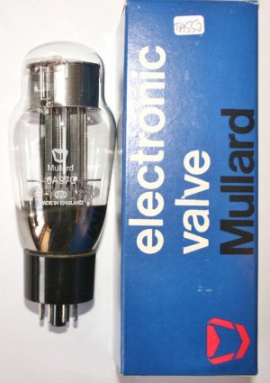

By the way... I hope I didn't waste my money but I purchased this Mullard 6AS7G. I wanted stay pretty close to the original design and I liked the look of this NOS NIB tube. I won't have much to compare it to but I like the getter at the bottom rather than the top. I have not figured out what the extra wide ring is at the top. Anyone know?

At least the seller listed it as Russian, which is probably what it is. Don't think Mullard themselves made a 6AS7 as that an American designation.
They did re-brand tubes, i have a pair of Mullard 6DN7's which they obviously didn't manufacture, but curiously they don't have any country of manufacture written on them.
I would lay money on them being Sylvania tubes, so i assume they were made in the US.

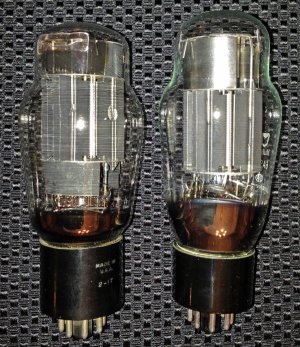

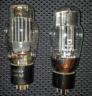

I received the Mullard 6AS7 in the mail today. Here it is next to a classic RCA 6AS7. The Mullard bottle is larger, the cooling fins are different, and the getters are different. The actual plates look the same however.

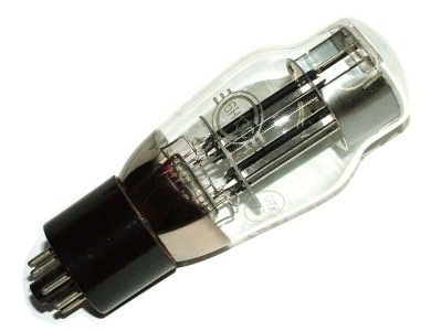

Your Mullard really looks like a rebranded Svetlana. I have one that states "Made in West Germany" (no other brand). If I'm not mistaken, I would say they were all made in Russia. IMHO, the big (at least bigger than my RCA 6AS7Gs) metallic deposit at the bottom of the tube is a good indication of Svetlana.
Fabien,
I believe you are correct. Here is a Svetlana tube. Looks identical. I hope it sounds good.
