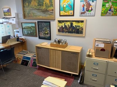

I have found the Van Alstine "HumDinger" DC Line Blocker noticeably abates the buzzing (your mileage may vary.)
Tucking away the Kaiju in a back-ventilated cabinet helps further with the noise abatement ... but, that's hardly a desirable solution; we want the Kaiju to be out in the open for everyone to admire! (See my Kaiju, photograph attached.)
I've been thinking about replacing the PT-9 Transformer altogether, to see if it is an issue with my particular transformer.
I'm open to all ideas!
