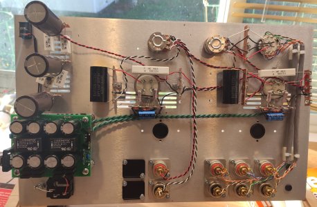

Wow! The stock circuit looks WAY simpler than that of the BeePre I built this past summer. Much more like the Moreplay I built not long ago.
Will the price of the basic kit be less than that of the original BeePre, perhaps?
Scott
The numbers I have pulled together suggest that the new kit will be a little bit less than the old one.  While overall it is far, far simpler and easier to build, the new power transformer is an expensive item and the voltage regulators we are using for the 300B filament are also shockingly expensive.
