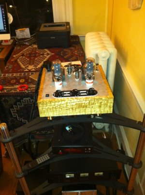

Attached is a picture of my Beepre. I cannot be more pleased by its sound -- a very clear step above Foreplay III which was itself a step up from a very good solid state preamp that I had previously. The only modifications that I made was to use sonicaps for daytons and silver and copper wire from vh audio, instead of cat-5 cabling. This was the first time I have ever veneered anything, and I am grateful to JamieMcc for his helpful advice.  I did it without using vacuum press.  I have had problems with one channel, which thanks to PB I have finally figured out (a loose wire in a relatively hidden place, 5L). I should also like to give a shout out to Eileen, Josh, and the Doc for being so helpful.  Finally, I strongly recommend Genalex gold lions. They look exactly like EE300b, but they have a richer mid-range and are less microphonic (they also weigh more).

Good Lord    having worked with many woods in the past, this sort of thing tempts me to go back. The Bee Pre is quite an impressive looking design by itself, but this base squeeks clean the competition.
