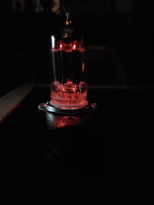

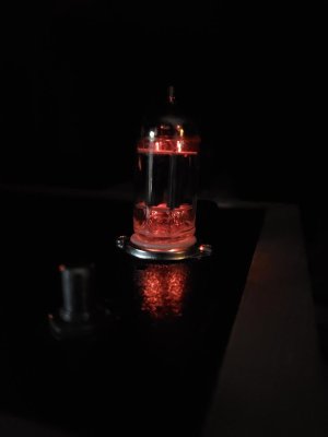

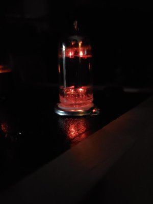

Thanks Paul for helping me out with this.
A2 measures 0 volts
The LED Attached to A8 Lights Up
The LED Attached to A3 Doesn't Light Up
Troy
Let me know if you need any different angles

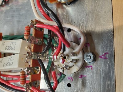

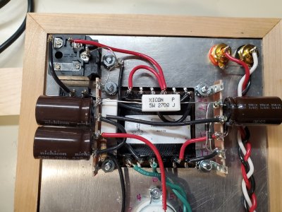

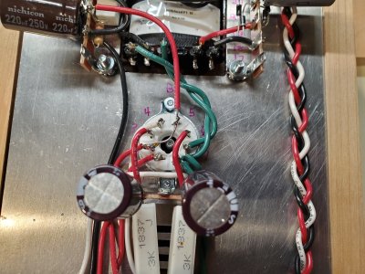

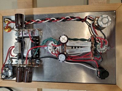

Alright, how about some fresh build photos?
OV at A2 and A3 with 55V at A1 makes me moderately suspicious that pins A3 and A2 are touching each other, which would short them together, then you'd get the 55V on A1 because of this.
This should be visible from photos, and you could measure DC resistance between ground (terminal 3 or 12) and A2, then ground and A3.
Let me know if you need more angles or anything clearer.
