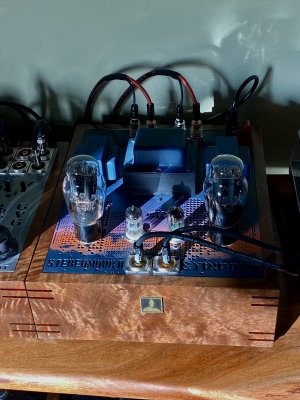

I am happy to report that I completed the build late last night. It passed all tests first time through, and I had it singing minutes later. It sounds amazing, naturally ;), thank you Doc, Paul, Paul. The output impedance switching is interesting, very audible differences. More on that later when I have had a chance to digest it.

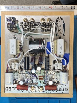

All that white wiring is 16ga braid-shield twisted-pair multi-stranded silver-plated teflon-insulated wire (sounds fancy on paper), but is an absolute bear to work with. Seemed like a good idea at the time, but I cannot recommend it. It does neaten the appearance of the 2A3 heater wire and the output spaghetti bowl. And, contributes to the amp being very quiet, the tiniest bit of heater hum from the left channel, but I need my ear 2" from the driver to hear it with very efficient speakers.
I am not completely finished. At a future point I will be adding the Shut Regulator upgrade, and I have some RCA 2A3 black plate NOS waiting in the wings. Oh, and I have some figured Claro Walnut I plan to use to make book-matched bases for the Stereomour and the Moreplay set.
Thanks for all your encouragement!

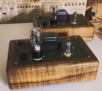

Is there a good source for pre-milled claro walnut?  I rebuilt some amps a while ago that came with bases made out of that, and people keep asking if I can make more.
On that filament wiring, adding the DC filament upgrade will remove both the heater hum and most of the potential noise induced by having those heater lines running around, though it sounds like your speakers aren't so extremely sensitive that it's an issue.

I bought my Claro Walnut here: https://nwtimber.com. They specialize in highly figured, musical instrument grade, etc. So pricy, but they sell very nice stuff. Another good source for more "mundane" Claro is https://www.macbeath.com. Both sell lumber, so I am doing my own milling of the base.
I'm hoping the hum isn't from heater wires radiating, because my right channel is silent, and the 2A3 heater leads are shielded with similar construction to the 12AT7 heater wiring. That said, I haven't spent much time fiddling with it so I don't really understand what's causing it. And, it's very minor anywise.
I'll have to pop by since they aren't all that far away.  I bet they could just whip out bases and finish them in house very easily.

Yeah, everyone was like "wow, good job building those bases", and I had to break the bad news to them that I have no idea who made them or where they came from.  I sure would like a few more though!

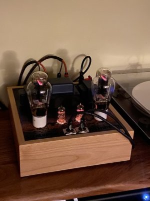

Nice stuffs fellas! Shunt regulator .... yeah it's cool you are waiting on that because it will give you a good idea just how great the Stereomour II can be. It transformed mine.

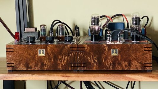

It's taken forever, but I have finally finished the Claro Walnut bases for the Stereomour and Moreplay. It was a painstaking process because I am terrible at mitering and this was an amazing piece of wood that I didn't want to F-up (required building a custom jig to do it properly). I wanted to book-match and grain wrap the bases and to try a french polish. It took somewhere between 30 and 40 coats of shellac, but I really wanted to do justice to the spectacular grain.
Over the past few months I have fully burned in both the original Psvane tubes (good) and a pair of matched NOS RCA Black plates (amazing), and damn! The Moreplay & Stereomour can really sing!

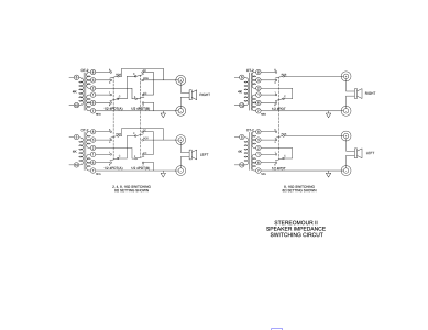

And, way back, I had promised to discuss my experience with output speaker impedance switching. Initially the amp was connected to 8 ohm speakers. I played around with it a lot at first and noted both louder and more high-frequency emphasis the higher I switched the impedance. Most notable, it sounded more exciting at 16 ohm, but also a bit more fatiguing, suggesting maybe more distortion. It may have reduced the bass at higher impedance settings, but that was hard to detect due to the higher output. 4ohm was a little muted, and at 2 ohm it just sounded lifeless and dull. I think a significant part of that impression might be due to reduced volume at lower impedance settings. I spent a lot of time listening at 16, 8 and 4 ohm, and eventually settled on 8 ohm as the best balanced.
More recently I have switched to 4 ohm speakers and after a relatively brief audition at various settings landed on 4 ohm setting as the best balanced although 8 ohm is not bad sounding either. A side note regarding my speakers, they present a flat impedance load at the nominal value to the amp from 0Hz up to about 5K gently rising to about double nominal at 20kHz.
Jon,
Here is my speaker impedance switching circuit, and how I would implement an 8-16 ohm switch. Note these circuits are specific to Stereomour output transformer wiring and might need modification for other output transformers.
