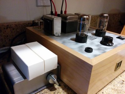

So far still working no unusual things happening i will run it for a little longer and see.
i luvmusic 2 said:. . . IMO when it comes to music/audio gear it's most likely a personal taste, Sounds that is good to my ears might not for others it's like one of those cable/capacitor debates but lets not go there.
Paul Joppa said:So I fired up an old spreadsheet and looked more closely at the 6SN7-GTB. It should work just fine, and within spec. Output is about 3/4 watts, damping factor 1.0.
A speaker with a very low QT could work really well with the low damping factor; for example an FE-206E Fostex in a 1 cubic foot box tuned to 50Hz or a bit lower. Try a 2.5-inch ID tube 4" long. Parts Express has ready-made 1.0 CF boxes.
I'am Glad that you are enjoying it too as i do.boulos said:I just tried a pair of Toshiba 6SN7GTB I have lying around. I'm really enjoying the sound too. It's more chill than the 6DN7 (usually have Sylvanias in there).
i luvmusic 2 said:I'am Glad that you are enjoying it too as i do.
