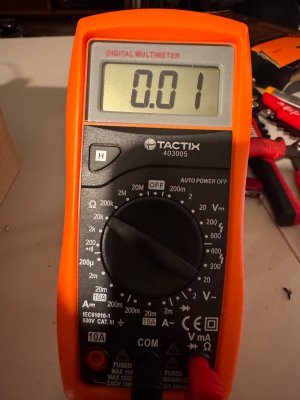

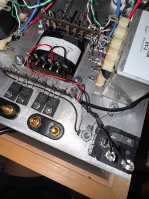

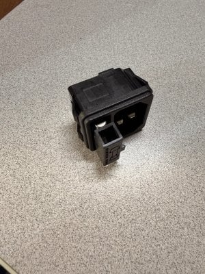

But know I have another issue. I did the power transformer input wiring for the 115-130V AC range. I followed to page 35 for the Power Transformer Secondary Test, I tried to read terminal 7 and 9, plug the cord but I’m gerting a 0.01 reading. It kind of makes a brief clank noice as if when you turn on an amp but the reading just reads 0.01.
I dont know if it matters but I should better say it. Before removing the black wires that I mentioned I had to cut because I kept going after getting the 150v reading, I did a test until I realized I had to take those cables out to get a reading, I dont know if this affects anything.
I’m uploading an image. I was hopping for it to go smoother than this, sorry to be bothering with so many dumb questions.
Thanks in advance

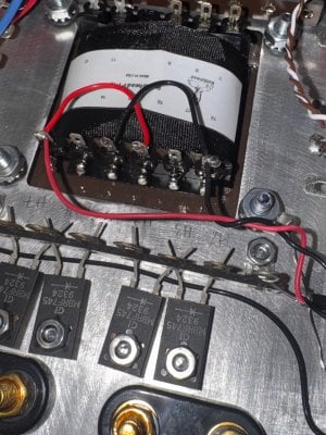

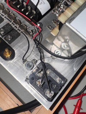

Are you still seeing the 120V AC between terminals 16 and 18 on the power transformer?

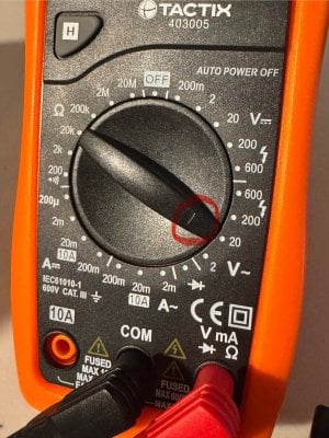

It's hard to tell with the photo of your meter whether you have it set to read ohms or set to read AC volts on the 20V scale.
Thanks for keeping up with me.
I did the test on terminals 16 (red) and 18 (black)as you role me and it just reads 0.2. I guarantee its on Volts and not to read ohms.
I did the test as well on terminal 12 and 11 and it reads 0.2 as well.
I did again the test on terminals N and L on the plug and reads 0.01 not 120V anymore (I dont know if having the cables attached and soldered to the power transformer makes it unable to read 120v again.
And the test on terminals 7 and 9 read 0.01
And i also tried to test continuity and the switch is working.

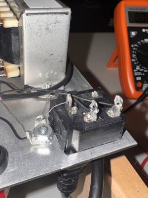

I’ll upload more pictures to see if there is anything I’m doing wrong. Also a close up on the meter in which I’m doing the tests which has a little arrow I’m marking in the pictures.

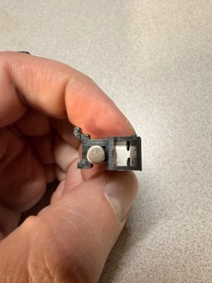

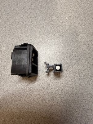

To be clear, this picture shows the fuse in the wrong slot in the holder:
And this is installed in the correct slot:
