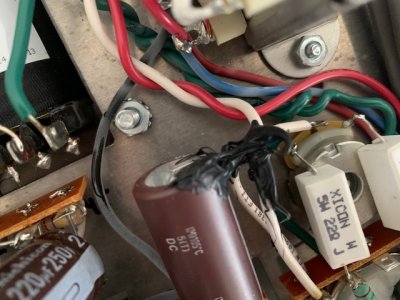

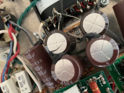

3. There is some weird black gunk on parts of the amp that wasn't there before. Looks like it could melt (further). Should I try and remove this? Paul, can identify this?

The black material is a high temp adhesive that has been applied to the capacitors to keep them from getting knocked around in shipping. It can stay.
