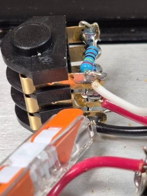

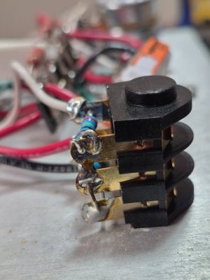

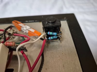

Hello,
I recently swapped out the trs jack. Afterwards it worked fine goes a few days, then it would randomly cut out, which could be fixed by lightly brushing a finger on the headphone plug or volume knob. I reflowed the solder on the trs and pot lugs, then the R channrl just died.
Resistances check OK. Voltages are basically OK, but all 0 voltage lugs read 0.4-0.5 mV, and lugs 2&4 are a smidgen over 10% high at 183.3. Both tubes have 2 filaments glowing, both diodes on the A tube socket glow. Tracing the red wire through the circuit measured 0 ohms, except across the pot, where it was consistent with the white wire at various volume settings. Switching tubes did not fix it. Switching the input interconnects still left the R channel dead. The headphones work fine on a different amp.
I did use a different brand of trs jack.
because I could combine shipping costs with other stuff I was ordering. Surely that should not be an issue because the jack initially worked.
Help! I am at a loss!

Those joints on the headphone jack are pretty "fluxy". I would guess you might need to reflow them one more time to be sure the flux is not interfering with the connection. The middle contact is the right channel connection so maybe focus your effort there.
Joints reflowed & R channel still dead. HOWEVER, I discovered that if I wiggle the 6080 tube in the octal socket I can get the R channel back. I can make the left channel cut out. I can not nudge the tube to a stable spot where the sound is always good. I can replace the tube and the problem remains. By my eye there is no trash in the 8 sockets.

I would not expect the soldering of the red wire onto the headphone jack in your posted photos to be sufficient for that connection to work.
