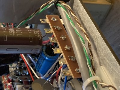

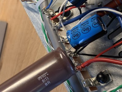

I bent one of the caps out of the way for the pic. Orientation normally matches the instructions.

I just wanted to make sure the shoulder washers were in place.  If a shoulder washer is missing from one of the terminal strip terminals with a plastic acorn nut, you could end up with some hum.
Ah okay. I checked and they're both there.
Does it sound like a grounding issue? I've gone through and looked at all the solder joints, but there could be ones for grounding that need to be reinforced.
It could be loose hardware, it could be a power line problem (still seems unlikely in your case), or external interference.  You're certain 36L isn't touching the power transformer mounting nut right?
