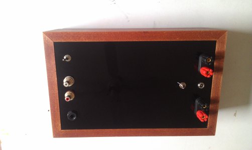

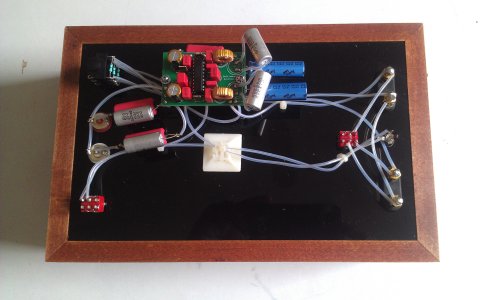

Thanks for your help implemented as instructed including the hole in top plate works just fine my fostex speakers  now do not jump out of their baskets when being switched on  such a simple thing overthought it thus my difficulties glad I asked for help as would  still be pondering how to implement this. Will post  a picture when phone has recharged to show in in situ .Again my thanks .

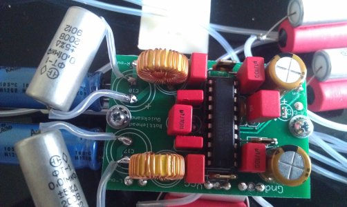

As promised pictures of mute switch and reinstalled c5 capacitor amplifier works like a charm sounding better each day .thanks a lot.

Oh, yeah, I didn't notice that.
If you're going to power the  Quicksand from a wall wart or other switching supply, capacitor selection on the PC board will be critical in more locations.

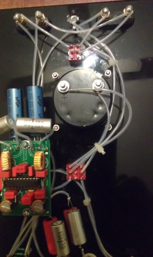

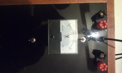

Have completed all I wanted to do to the the quicksand now the volt meter has arrived fitted today fairly straight forward but no template .Works  as it should  will rebuild quickie preamp next year to incorporate these meters as an indicator of batteries running out.Now back to the music.

Must admit had not given any thought to that aspect of things.The amplifier continues to improve I cannot believe the sound quality for the money superb ,from what I have read the parts to burn in last will be the Russian Teflon bypass caps I have used so the sound may change again slightly over time  must have about  80 hrs on the amplifier so I will see.
Hi,
Someone might have asked this already, but what kind of wire did you use?  Also, where did the voltage meter come from?
Dave
Wire used is 0.5mm pure silver as had some spare on a reel from about 10 years  wire with Teflon insulation Teflon used as does not melt so readily when in contact with soldering iron,there is some debate as to which insulation to use but I find this works for me a now middle aged and hands not as steady as once were . The meter was from this seller on ebay sellerbible price was around £3.21p cheap and works well given coming from china delivery was quicker than expected.Hope this helps also  there other sellers on ebay selling these analogue meters if hey should run out of stock.
