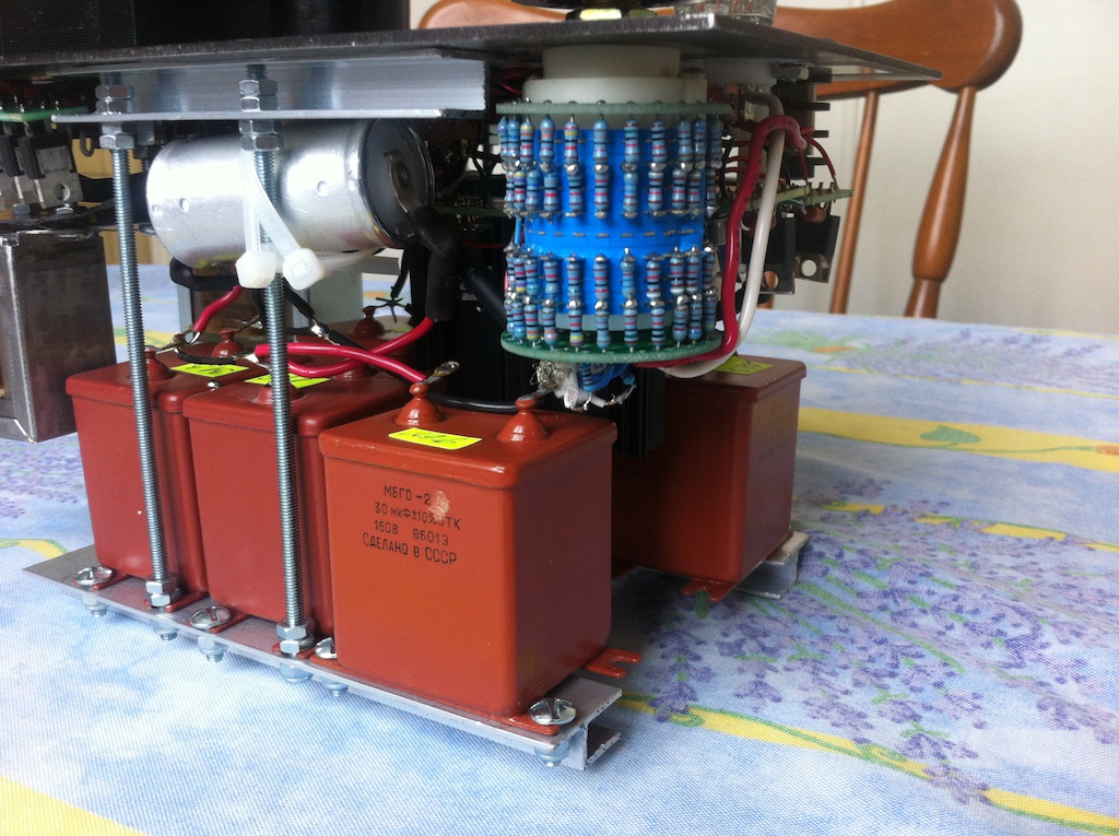

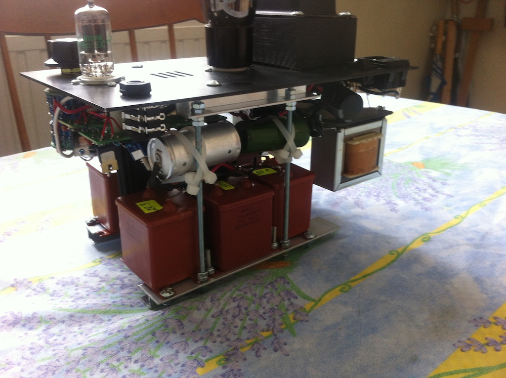

Small follow up on the Russian MBGO's. Now about 80 hours in.
For the money (35€ shipped) they are really great! Big improvement over the stock electrolytics. Add a lot of depth to the music.
I went for 3x 30uf on each channel. Could have put an extra for each channel for lower impedance headphones but wanted the extra room for bypass caps and the PS cap upgrades.

What's going on with your attenuators knob? I suspect you can adjust its height so it will sit flush with the top plate by winding up the nut below the top plate up a few turns.
Crack only grew a little taller. The footprint is the same. Even better, because of the new height i can strap the Schiit modi2u vertically behind the crack to gain some desk space.
