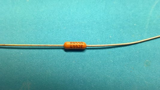

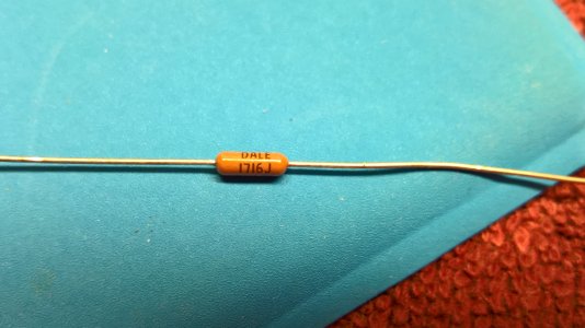

I got the kit today and took inventory and started the mechanical part....am short one of those #6 fiber shoulder washers that are used to mount the smaller transformers to the mounting plate and 2 49.9 ohm resistors, got 49k instead.... :>)
no biggie, sent a note to the parts email and got a fast reply from Josh! Thanks for the fast reply...I am continuing on the build and when the washer and resistors arrive it will be a simple install....

Could you post a photo of the 49K resistors?  49K is not a value we stock, but once every 5 to 10 years, the wrong resistor gets ordered or the supplier packs the wrong resistor, so it would be good to see what you have on hand.
Here ya go....

Josh is aware of the issue. We did get the wrong value and the correct one is on the way.
