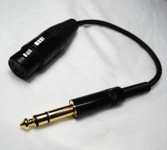

Alex if you decide to chop off the end and do it yourself the smart thing to do is make the cut 5 or 6 inches back from the jack that way for the cost of a a nice male and female neutrix xlr connector you will also have made your self a handy xlr to trs adapter out of the short off cut off piece.
Their are a couple of how to tutorials online for this mod that's how I did mine you end up with a short adapter like in the pic

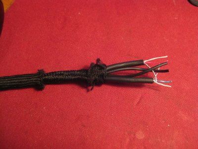

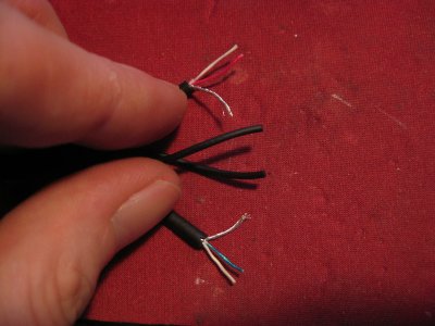

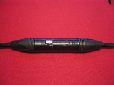

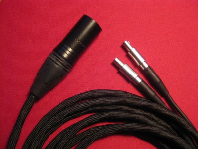

I did the same mod as Jamie on my HD800 cable. ...you just have to summon a bit of courage to make the cut.

Where did you get the two adapters?  I am not afrdi to cut vs $150 for another cable...ok with the solderig etc...

I doubt there is any real advantage to adapting a common cold leg for right and left type of TRS cable to a 4 pin XLR. The idea behind the 4 pin XLR is that you can use separate hot and cold legs for each channel, i.e., a four wire cable all the way back to the drivers.
The HD800 cable is a four wire cable with the two cold legs joined at the TRS plug. Cant speak for the T1's as i never owned them.

Cool, so in that case replacing the TRS plug with a 4 pin XLR plug will indeed change the cable to separate cold legs. But making an adapter with an inline TRS jack and 4 pin XLR plug will not change anything.
