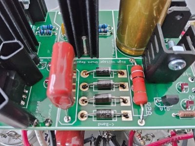

This does not look good though, solder points for diodes look burned!
That's not the section that makes the 6.3V regulated voltage to heat the tubes, that's along the back edge of the board with the 1085 regulators.
Perhaps a 1085 and an MJE5731A got swapped?
