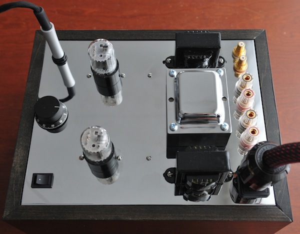

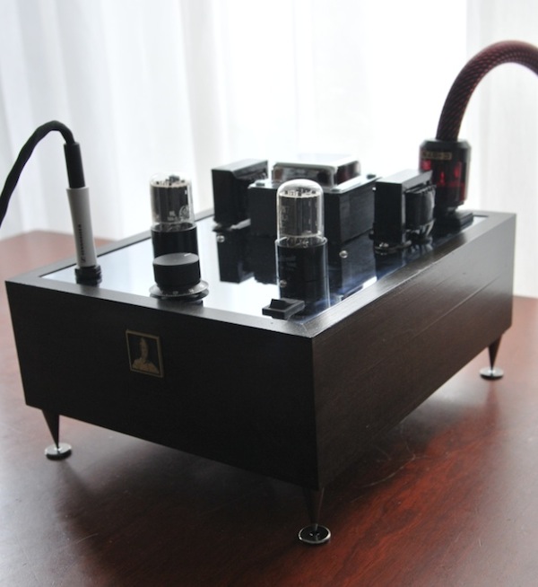

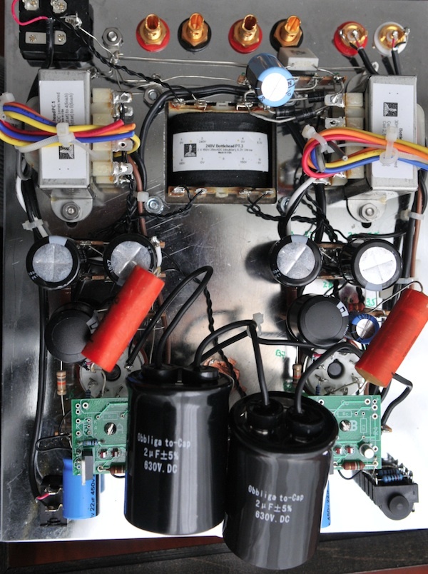

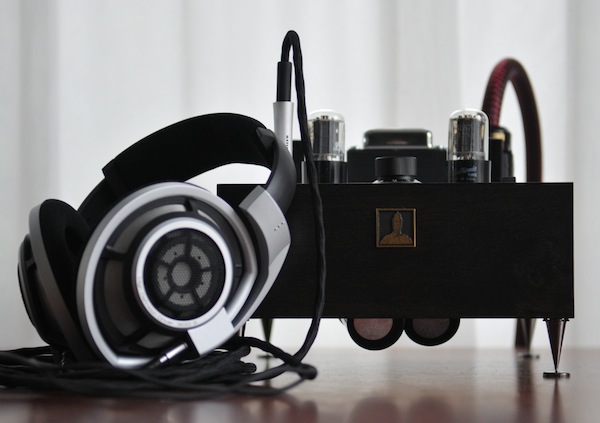

I have just finished my S.E.X. Bottlehead Headphone Amp, the following is customized:
- RCA plugs and Speaker plugs are form CMC
- Vintage style volume knob
- C45 board
- No speaker connection wires (optional)
- 2 x 1.0uF 630V caps --> 2 x Obbligato 2uF 630V caps
- 2 x 0.1uF 630V caps--> Jupiter Beeswax 0,10uF 600V
- Top plate is rebuild from copper and chromed
- Top plate transformer is chromed
The only thing left to do is to figure out how to keep the big obbligato's in place ;-)
Connected to my Senns hd-800 the S.E.X. amp is already sounding great! Cannot wait to connect the amp to my Rega P3 and Music Fidelity pre-amp.
