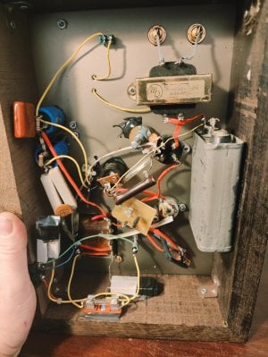

Hi all, sorry if this is the wrong space for this but I couldn't find a better one.

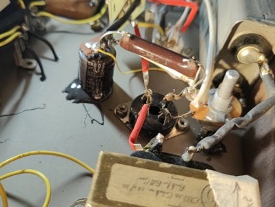

I just picked up some old paraglow monoblocks, with the cobalt transformers. I'll be moving them to a new chassis and I was wondering if there was any circuit upgrades I should be making, perhaps power supply? Is there a repository for this kind of info (revisions etc...)?
Happy to hear any and all thoughts on these. I'm a novice with a little bit of experience with kits etc ..but looking to learn learn learn.

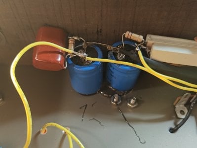

That was from the very early days of Bottlehead; in fact I'll have to check my files to see if it was before the name Bottlehead was adopted! There doesn't seem to be a specific sub-forum under the "Legacy Products" forum - we'll have to make one. If I recall correctly, that was the first time we used parallel feed output transformers. It is a parafeed version of the Afterglow direct coupled 2A3 amp. I see it has been modified - the big capacitor glued to the side panel was not stock. A few more photos, of higher resolution, would help us identify any other mods and version - I think there were two different power transformers used, and the driver was probably a 5965 or a Russian 6N1P.
It's a rare beast indeed, and the cobalt transformers rarer still.
I'll dig up my old notes, but in the meantime just note there are probably a few changes that should be made for safety and longevity.

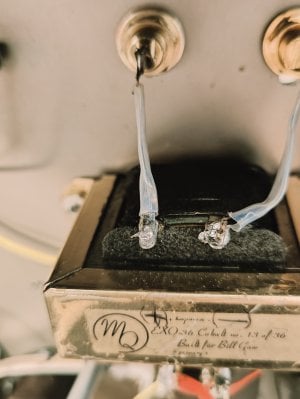

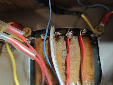

I'll grab a bunch of pics today. This one has the exo-36 and is the one Bill Gaw built for his article long ago.
Yeah those caps are probably 60+ years old. They won't be staying.
Because of the quality of the transformers it'll be a cost is no object on parts as I rebuild it.

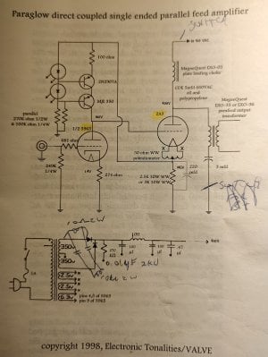

I found three draft notes, documentation I've been slowly working on. I believe PB has done some refurbishing as custom work as well. Note, there was a Paraglow II incorporating John Tucker's early implementation of shunt regulation for the driver. It was a non-Bottlehead modification kit.

That gave me a flashback. That run of transformers was unique. In or around 2001 Mike LaFevre asked me if I wanted to do a special run of cobalt transformers, as he had acquired a small ($$$) quantity of cobalt steel laminations. I don't recall production numbers but there were EXO-35s, 36s, 45s and 46s IIRC. Probably not more a few dozen total. One thing led to another and I ended up spending hours upon hours in the kitchen of the old farmhouse we had leased for that year, polishing the brass channel frames and flocking the bobbins. Yeah, only did that once...
The cobalt lams were interesting stuff. Whereas the permalloy transformers we had been selling had a great sense of delicacy but weren't really great at big transients, the cobalt could be really punchy with the tradeoff being a little less fine resolution. Not long after this Mike started mixing permalloy and M6 lams in an attempt to get the best ratio of fine resolution and dynamic capability.
I'm remembering that Mike felt you could push the cobalt quite a bit harder than M6. You might consider a circuit that can put out a little more power than the standard Paraglow. It was around 2.5W, limited by the direct coupling of the stages. Seem to recall Mike felt you could put more like 4W through them. PJ should probably weight in on this.
Yes, some really great sounding amps came out of the late 1990's experimentation. One of them is the cobalt core, which provides more headroom for clean transients.

Also, the 450V rated filter caps were really at their voltage limit. When we would get those in for refurb I would replace them with a stack of a couple of 450V rated caps in series, with 100K ohm equalizing resistors across each one to handle the startup voltage spike. Bear in mind that for two caps in series the capacitance goes down to c1c2/c1+c2 so you would need twice the capacitance rating for the new caps to retain the original capacitance spec.

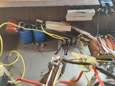

And I recall that the cathode resistors on the 2A3s were marginal in terms of power rating too. I seem to recall around 30W minimum is what they need to be.

For the filter caps consider some of the DC link film caps.

My list so far:
1. Replace 4uf motor run with mundorf 6.8
2. Fix up the soldered fuse
3. Replace RCA with kle - and wire neotech
4. Replace the 100uf caps with motor run or 2x 200uf + 350v+ and resistor to equalize voltage (wattage for resistor?)
5. Clean up the IEC wiring - replace with duelund 600v
6. Replace the 3k 12w resistor with 3k 50w rieden from connex
7. Wire mute switch to also turn off

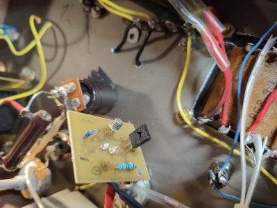

8. Use rod Coleman constant current board?
9. 0.15 duelund bypass caps on all capacitors
10. Change driver tubes to 6sn7?
