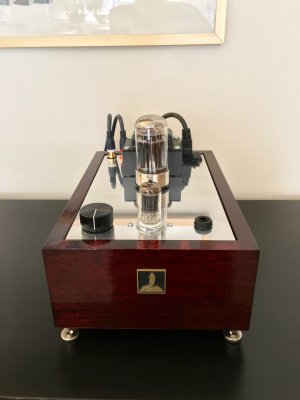

Hi all,

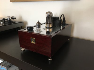

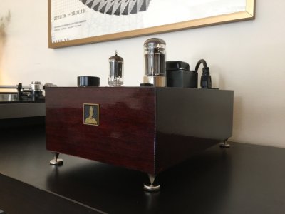

Finally finished my Crack with the Speedball upgrade. It was amazing fun to build and sounds beautiful, I listened to it for about a week without the Speedball and it makes a massive difference.

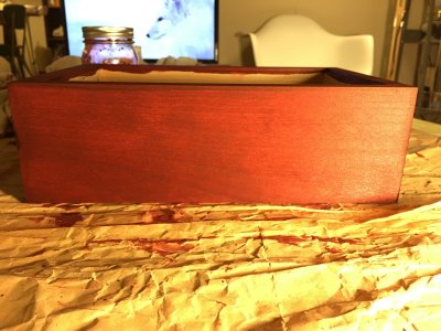

After sanding the base, I used J.E. Moser's aniline dye and finished it with five coats of Spar Varnish. I let each coat of varnish dry overnight and then sanded with 400-grit sandpaper each time to get a smooth finish.

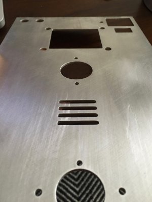

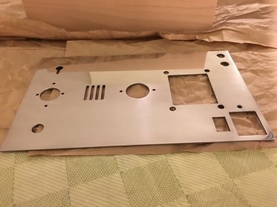

The top plate took a crazy amount of hours to get the mirror finish. I started with 200-grit and worked my way up to a 2000-grit wet sand. After that I used S100 Polishing Soap and then Blue Magic Metal Polish Cream. I also swapped out the volume knob for a solid aluminum one.

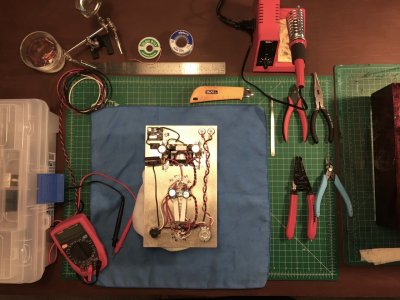

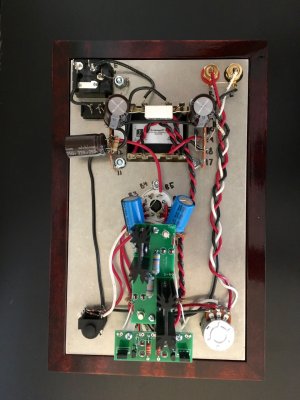

I also did the pot mod (thanks to adeep42 for the resistors) and headphone jack voltage mod after these photos were taken. I think my next project will be a matching Eros. Let me know what you guys think!
