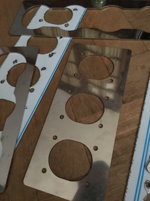

Just attached two pics - on one you see the mirror quality chrome nickel steel covers my friend lasered for my home made power strips (they are not yet finished but soon they will) - looking forward to use them in my main system (as I have a slight hum problem and maybe with the right cables, stargrounding, graphite shielded cables etc I might get rid of it completely in the end - but this is something diffferent.
I attached the picture because I am planning is to have Kaiju top plates lasered as they look amazing - maybe someone whants to join me? Bottlehead does not provide the cad files to have them lasered - I already asked Joshua, but this no problem, or not a big thing - it is easyly possible to transfer the measurements from a existing top plate to the laser to do some more.

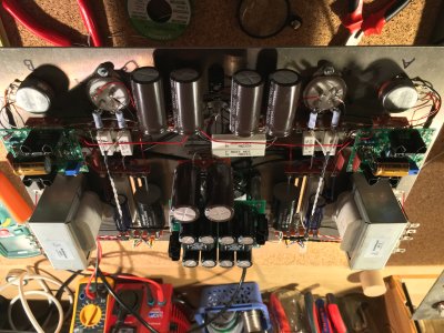

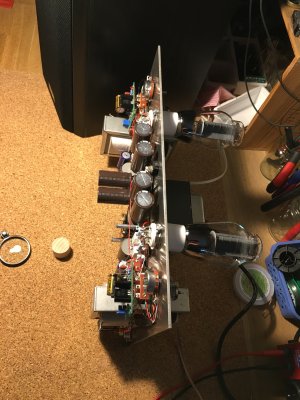

Another question: What do you think - is it okay to turn the amp on (actually I am using a big Variac to slowly raise the voltage) while it is standing upright like shown? I just thought like this I can see the assembled parts and if the magic smoke is about to leave the circuit I am able to react to avoid the worst!
I am so damn nervous right now again - just feel a bit childish at the moment but I am really scared to proceed an do the final checks! I just don't want to screw it up in the last moment just before crossing the finish line - maybe someone can come over to hold my hand while turning up the Variac...;o)
So, let's do this NOW!

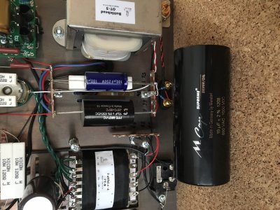

I just made a picture quickly to show what I mean regarding caps size.
Another possibility to solve the space issue would be to have my own top plates lasered (already mentionned in another post) and move the solder lugs a little bit -  a friend of mine - it is actually my neighbour living in the next house down the street - used to work in the lasering departement of a coffee machine company where they work a lot with chrome nickel steel in mirror quality and he still has the connections there and is able to draw the files needed for the lasering process - but this would really be a RR solution - but it would look very nice - if I go for an option like this it would be great to have a group together cause for one or two pieces it is not worth to start that laser.
What is the next project you are planning? What speakers do you actually use / own - you mentionned "your speaker developper" - I am just very curious as I am thinking about some open baffle designs - but I'm not so sure if this would work in my rooms (I have two listening rooms at the moment - maybe soon three as there are still some unused rooms in the house I live in).
And I am just thinking back and forth about ordering a bee pre as mentionned - but decided now that first the Kaijus have to be up and running. It would be great if you could share a bit of your experience regarding mods though I know you do not use a preamp at all.
Anyway - please tell me how you got the mundorfs fixed inside the Kaiju...;o)

I merely removed the original cap and place the mundorf inline, hanging from it's connection wires. I didn't have a problem getting under it to solder the leads. I was careful to allow as much air space between the cap and the resistor as possible.  In another post, I measured the temperature of this cap while running.
I am sure you could attach a support of some sort if you wanted but I have never had a problem with mounting caps this way. I do not move my equipment and it certainly doesn't get a lot of vibration.

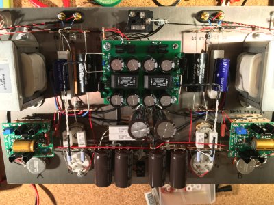

thank you so much for the picture - great...;o) I'll try it with some sort of support - got something in mind I'll work on - I mean for a perfectionism freak like me there is no other option anyway. I installed the DC Filament upgrade last night - will check out tonite - it was actually quite difficult to rewire everything as I took the word "attach" very serious - so I had to use brute force to get it done - hope I did not damage resistors by overheating them etc. - I attached a picture for you. The VCaps and Mundorfs I'll use in my next Kaiju where I go for complete solid core silver wires with teflon sheating - let's see...;o)
