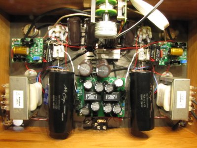

finally complete with tubes and all modifications in place, well except I have some Mudorf Silver/Oil 10uf's on the way. But that is the LAST thing I am doing, really.

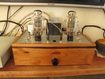

I am thinking of adding these transformer covers over the chokes. I think I like the clean look and the driver tubes stand out more against them. They need to be modified slightly to fit just right.

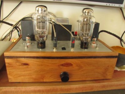

Mundorf's are in!  As soon as I get a new driver tube, I can start listening again.
