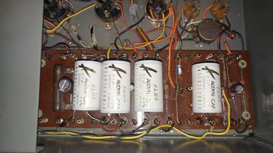

JamieMcC said:
The 10uf  Audyn interlink Plus capacitors are a nice fit in the Mainline ;-)
Do you mean this one?
https://www.parts-express.com/audyn-cap-plus-10uf-800v-double-layer-mkp-metalized-polypropylene-foil-crossover-capacitor--027-141
Yes those ones in your link, I picked a used pair up off of ebay to try out in my Mainline for £15 the pair! Worth keeping an eye on used listings lots of interesting options turn up in the 8uf-15uf area for a fraction of the cost new.
Will see if I can get to the amp to take a pick for you later.
Ok found a pic, I have not cut the leads to size to permentently fit the Audyn caps as they have only been fitted temporarily otherwise I would have trimmed the leads shorter so the capacitors sat closer to the underside of the top plate  with a bit of Velcro added for further support. They do fit in the space nicely and their leads are pretty sturdy which helps when it comes to keeping the caps in place.
thanks for the picture. Very nice.
I may have missed it, but what effect do those caps have on the sound?

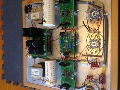

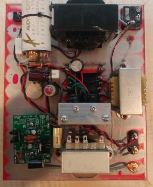

I'd vote for the Audyn caps as well.  I've used them a bunch lately.
@PB: What is that in your second pic?  A monoblock tubeless amp?  With 2 power transformers?
Edit: mistook what I now assume is an OT for a PT. Assuming 1PT, 1 OT and 1 Choke, what's the other transformer?
Power transformer, output transformer, plate choke, and power supply choke (not necessary at all, but the holes were already there).
