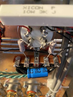

Attaching the pics of resoldered joints. Thanks!

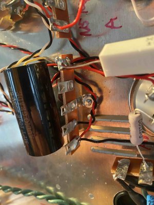

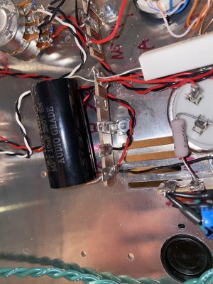

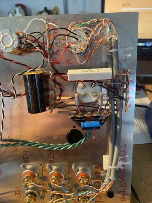

I have re-soldered all of the joints and I am pretty sure nothing is loose at this point. Still getting a much weaker signal from that channel, its pretty hard to pick up any AC signal from the outbound lead of the 10uf Cap. I am attaching resoldered pics just in case I am missing anything else. Other than that are there any other troubleshooting measures I should be doing?

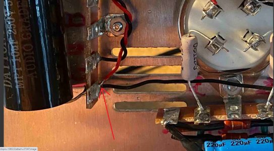

:O wow, its fully playing thru both speakers now. Thank you so much for walking me through this really long troubleshooting situation. It's silly it was a miswiring, but I am extremely grateful for your help and responsiveness.
