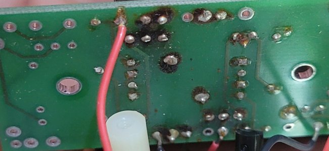

Ok after the amp came on, I played music for about an hour. Sounds great, turned off,, went out for a few hours, wouldn't come on when I got back home. I once again touched the two meter leads, one on ground,  one on pc2 transformer red wire tab that goes to the first tab on the board w 4 red LED's. It came to life,, Nothing seems to be loose.
I agree, just turned the system on, both amps working without probing. I'm going to meticulously check solders then voltages once I get manuals. Thank you
If you touch something in the amp with your meter probes and it magically comes to life, there's a loose connection or a broken wire.

It works for like a 1/2 hour and then stops so I go underneath and all I did this time was touch my needle nose to that bottom tab across from number 6 on PC2. The red wire that runs to the board with the 4 LED's when it's not working only one LED is lit when I touched my needle nose to it all 4 LED's came on and it started working.
Just a thought:
It seems likely that red wire is not reliably connected at both ends. Sometimes a wire is nicked when stripping the insulation from an end, and it eventually breaks inside the insulation. So check both ends of the wire.
If it's the one that goes to pin 1 of the tube socket, the end in the PC board may have a cold solder joint - that goes to the collector of a power transistor, which acts as a heat sink and requires extra heat and/or time to make a solid connection. So check the transistor connection as well as the red wire.
Hi Paul,  its the red wire that starts on the terminal Across from terminal 6 on PC2 tf,  it goes to the 5 tab Distribution brown board Which then splits to 2 reds, 1 red going to the i on the AB greenboard the other red going to the yellow capacitor board. Hope that's clear. I'll look into your suggestion.  It's been working for 3.5 hrs so far. Thank you
Took me a while, but I think I understand. (PC-2 is a plate choke; the terminal across from 6 is 5, the capacitor board is actually the power supply board). The wire connects the plate choke to the high-voltage power supply, so if it's not making good contact the output stage is not powered. The junction of the high-voltage power (under the green board) has several wires and is hard to see, so that's a likely spot for a marginal solder connection to happen.
These are just ideas for tinkering until the manual shows up; the real diagnosis starts when we have measurements, tinkering will then be much more likely to help!

I just took this video now I turned the amp on once I got home only only one red light was on this time instead of touching number 5 on PC2I touched the tab on the Brown 5 terminal distribution.
