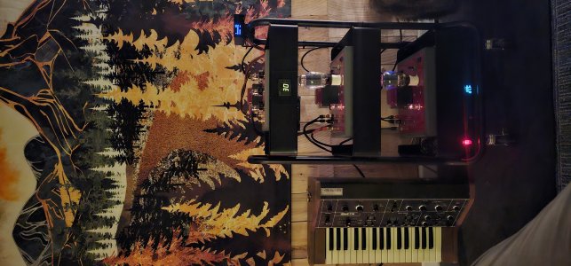

Hi, so on amp B,  I replaced the 90.9 and the 431 on both the nine pin socket and the board. The tube is not red plating anymore.  I'm glad I asked about stocking up on Parts because I should have checked that resistor. Maybe that was the issue thank you for all your help. Here are my voltage readings for amp B and A

Oops. Yes. I fixed it and also added the voltages from amp A.
The majority of the work was done on AMP B the only thing I've done so far to amp a is replace the mje because I did it on AMP B
