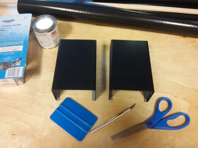

thanks for the updates to you and to John S. Exciting times.Caucasian Blackplate said:I worked a bit today on applying the carbon fiber vinyl to the DAC enclosure covers. Doc B. showed me some of his mysterious techniques, and these will be keeping me busy for a while!

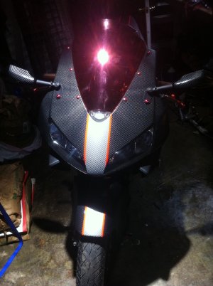

Doc B. said:The CF vinyl was inspired by my CBR project. I was happy with the look and when we wanted to do something to the DAC cabinet that was a little different a light bulb went off.
