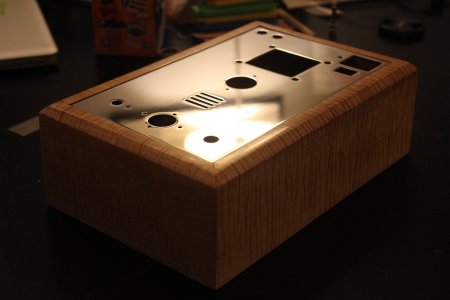

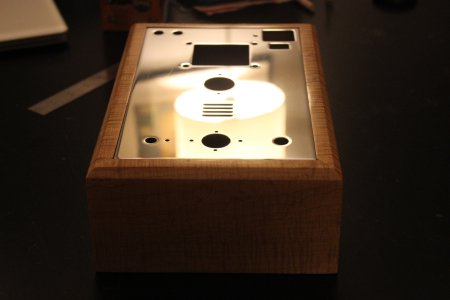

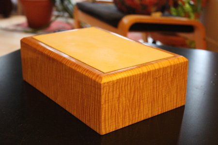

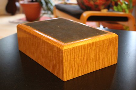

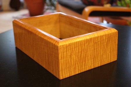

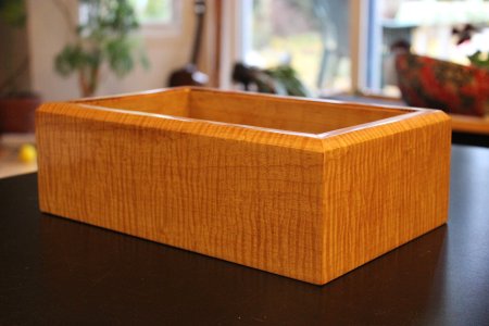

my crack is on its way and I should receive it in couple of days (wouhou !!). In the meantime I wanted to share with you the custom wooden base I've built couple of days ago.
Flamed maple with couple of discrete bird's eyes. Very (very) fine sanding // shellac washcoat // 2 coat of dyeing // handmade french polish (not finished, only one pass done) // many other fine sanding between each steps.
I'm very impatient to receive my Crack. I'm much more confident in woodworking than soldering and hope the building will be fine. What I worry the most is cold soldering.. I don't know if could even notice them by myself if I do some. Anyway, if I have questions I'll ask here..
Almost forgot, I coloured in back and white the two faces of my template. I think I'll go with the white/ivory top... opinions ?? :)

What a stunning base! Fantastic.

WOW! That's beautiful. I especially like the grain matching. You really made the most of a gorgeous piece of wood. Great job.

Thanks a lot for your encouragements. And Strikkflypilot, thanks for the link. It's very appreciated, that's exactly what I needed ! :) And yes about the continuing grain, I cut the wood from a single piece of wood.

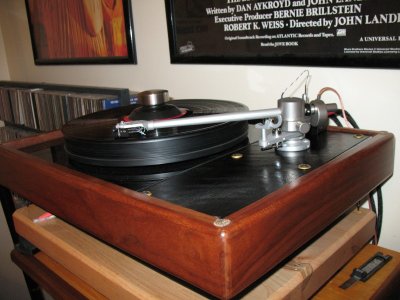

I dunno...like I told HW when we corresponded about my JMW9T being too tall on the standard HW-19 arm board and I made a thinner, damped and veneered version: upon seeing it, he said "you could start a business with those". My reply was, "why screw up a perfectly good hobby".

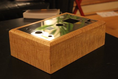

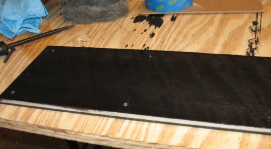

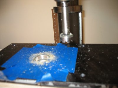

So I've started to work and decided to polish by hand (powder coat seems to be too expensive according to the estimate I received). So I did it the way people suggested in other former posts : wet and dry sandpapers, step by step 220 to 2000 grains, straights passes and then perpendicular ones, and so on // and use after that a polish (Mothers aluminium polish)
I think it look good BUT don't be fooled... There are still plenty of micro-scratches. They have been caused by the polish I've used. I may give an other shot later tonight. I read I could also use an other polish (Billet metal polish) which seems to be finer. But I don't want to spend too much time with the top. I want to solder now and am impatient to listen music with my Crack ! :)

Before you give up on powder coat, or anodizing which resists finger oils and scratches a lot better, try walking into a metals finisher with the plate and ask if they can just put your hobby item in with a regular run. All these shops run black routinely at least twice a week and it costs them nothing. I've never paid more than $25 for a top plate anodized. Once, the shop owner was around and when he heard I was building a tube amplifier as a hobby told me to keep my money.

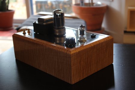

Hello, I spent the day yesterday building the Crack.
I still have to install the Bottlehead power cord kit and the speedball upgrade. I'll do it within the couple of weeks.
Everything went as it supposed to until the voltage checking, terminal 13 more precisely. I did a short-circuit touching the 270 ohm 5w resistor (between the terminal 21U and the 15U) and the terminal 13 during the checking. There was a little "bang" like a cracker.
The tubes seems to be ok (they still glow..), the fuse is also ok. I have to figure out the pb now. I tried the Crack with cheap headphones. It works fine until the left hear stop working in the headphone after couple of minutes. The voltage changed between before the short-circuit and after (terminals 1 to 12). The ones at zero remained at zero.
That's a shame to fail at this point. I guess I do my own experience. I'll be more extra careful the next time...
