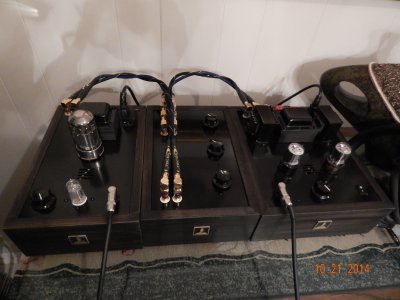

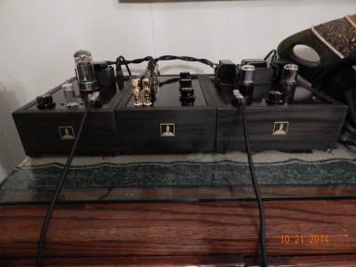

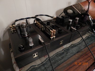

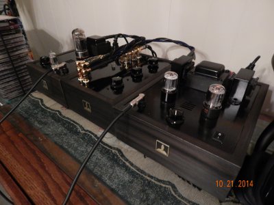

CRACK - SUBMISSIVE - S.E.X.....all in a row!
Decided to go sans identification plate - thought she would look better naked (just sayin').

Wow this is sexy. Sorry for bringing up this old thread but I was wondering, How did you get the mirror like finish on the chassie?
The top plate surface finish is nothing special.
Just a simple "rattle-can" spray paint:  Rustoleum Appliance epoxy.
About three thin coats.
Because it is an epoxy made for indoor aappliances it is glossy, super resistant to abrasion and scratches, washable, and easy to clean - just like you would want your fridge door.
Just make sure that all ground holes have no paint.  It isn't likely but when I did my Eros top plate there was spatter through some holes.

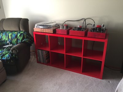

Great looking trio! My Reduction, Smash and Stereomour all have black powder coated base plates and red top caps for the power supplies. I used Aniline red stain from Lee Valley on the bases. Wondered how the bases would look as black and you have answered! They look great!
I recently made a trip to Ikea in Edmonton to pick up a bright red Kallax storage unit to use as a stereo stand. I love the look but when I look at the turntable base I think: "Paint It Black".
