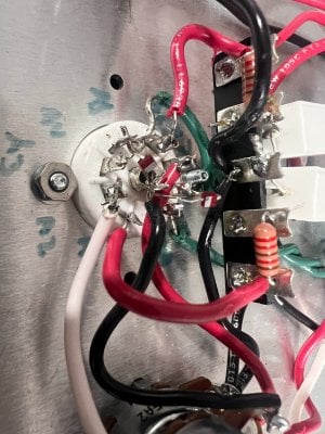

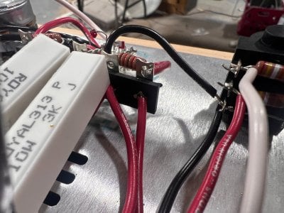

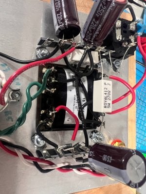

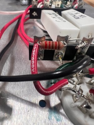

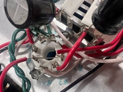

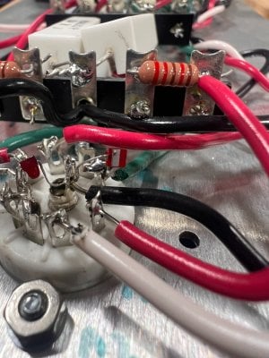

Hi all. Appreciate the help in advance. I finished putting together the Crack 1.1 OTL Headphone Amp Kit. I'm having two issues that I'd like help with.
One, the LED attached to A9 does not light up. The other LED does light up.
The second issue some of the voltages are significantly higher than what the documentation states. I've attached some photos of the build, and the resistance tests all passed. Here are the voltages:
ContactMeasured VoltageExpected VoltageHigh/Low/Normal
115450-100High
2168170Normal
31.10Normal
4169170Normal
57650-100Normal
610Normal
715390-115High
810Normal
910490-115Normal
1010Normal
Any pointers to where I should look would be appreciated. I traced back through the circuit and I *think* I have everything connected correctly. Thank you!

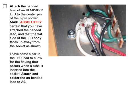

There is no LED that goes to A9...
After you fix that, I'd watch this:
To view this content we will need your consent to set third party cookies.
For more detailed information, see our cookies page.
You want maximum heat on your iron and solder with lead in it. All of those joints will need more solder/heat to flow out and work properly.
Thanks for the response Paul, I will improve the soldering on those joints. Regarding the LED, on page 64 of the documentation it states to attach and solder the unbanded lead to A9. Am I misreading or looking at the wrong thing? Thanks again for your help!

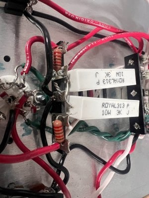

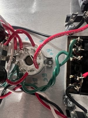

Thanks guys very much for your help, and for updating the manual. I've resoldered the joints and the voltage readings are stable. The LED attached to A8 still won't light up, and the one attached to A3 blinked a couple times and now won't turn on when I tried to measure the voltage across it. Are there other voltage readings that I could take to help pinpoint the problem? I've attached updated pictures.

The solder joints I'm seeing are still not going to work. Please watch the soldering video I posted on YouTube, then you'll know what you need to do and what you need to look for in a solder joint.
(Note that this is not the solder joints on the LEDs, don't focus on those, they have low thermal mass and solder easily, but rather focus on the rest of the kit)

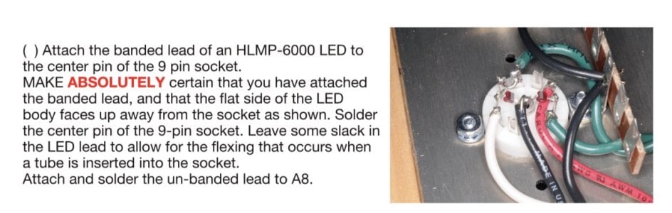

Weird. My manual, downloaded 6 weeks ago, shows A8, but it’s on page 36. I must have an older manual.
I migrated the old manuals to the new one. I don’t know how it happened but that number was changed in the process. It’s been corrected.
Just to follow up, I resoldered all the joints after watching that video but still had issues, including both LEDs not lighting up. Measuring the voltage across the LEDs indicated that they were bad (an earlier screw up by me somehow). Once I replaced those, both LEDs lit up and all voltage measurements were within the acceptable range! I have a working device! It sounds great; I couldn't have finished this without your help. Much appreciated!
