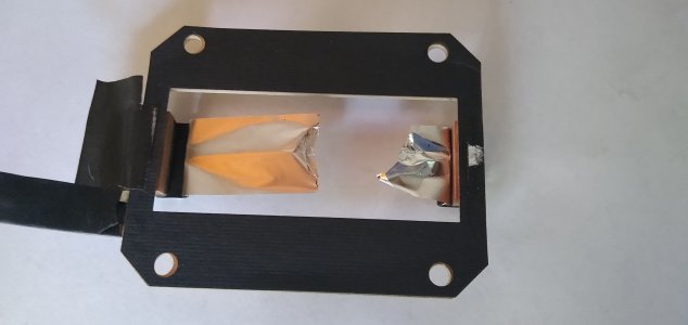

If anyone is interested, attached is a photo showing what happens when you fry a ribbon.
