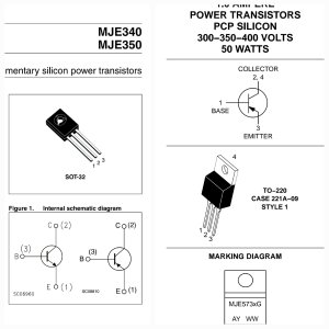

On the mje350
1.emitter
2 collector
3 base
MJE5731g
1 base
2 collector
3 emmiter
So I will install backwards.

The MJE5731G I ordered is 350v
There is an mje5731AG that's 375v and available.
Should I have ordered the MJE5731ag ?
https://www.mouser.com/ProductDetail/onsemi/MJE5731AG?qs=R2UZ7gjkEjIIBIrVFKMX3w%3D%3D
Yes , the 375 volt will be more reliable. The higher voltage is the primary reason for changing from the MJE350.
If there were an even higher-voltage PNP transistor available, I would probably want to switch again.
Either one will work adequately in the Paramount.  The change is to buy a little extra tolerance to high voltage (the MJE350 is rated for 300V max) and to better handle the thermal requirements in that position.
The presence of the MJE350 in the original circuit was likely the cause of the fried zener diodes.
Don't hesitate to clip a little heatsink onto the 5731A down the road if you can.
