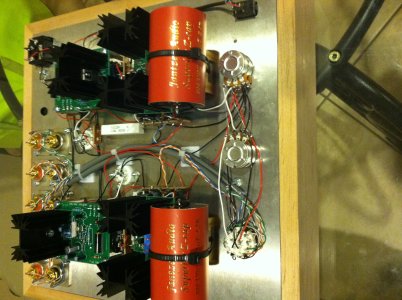

Well, the basic build is done.  I decided to have a beer rather than do testing tonight.  ;)  I was at it for about 7 hours today.  I'll do testing tomorrow night and if all goes well, install the Bequiet next weekend.
Here is a quick iPhone pic of the business end for now.

Well, I just ran all the voltage tests tonight and everything is spot on right out of the gate.  Guess I'm getting better at this.  ;)
Tomorrow night I'll give it a listen and then this weekend if all goes well I'll install the BeeQuiet.
