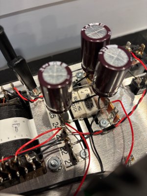

I've been over every solder joint in the amp and checked each wire's continuity and haven't found the source of the hum. This morning I noticed a burned spot on one of the 270Ω wirewound resistors. Could this be the cause, and what would cause it to burn like this?

New resistors are installed correctly along with new wires from 25L to 33U and from 25L to 31L. I’m afraid the hum is still there. I’ve reflowed every joint in the amp again and  replaced several wires. I’ve even run a direct wire to ground at every ground termination point to check for broken wires but the hum is still there. It’s a little more melodious now (a slow pulsating sound) but it’s very much present. I’ve run out of options with the solder joints so I have a couple of questions:
1.) Is it possible that a component on one of the boards is bad?  I’ve prodded all of them with a chopstick but there’s no indication of trouble.
2.) Could it be the transformer? I’ve reflowed all of the taps.
If you had a whacky voltage, then maybe there could be a dead part on one of the PC boards.  Likewise, a failing transformer is going to throw out some odd voltages.
Loose hardware can also create the problem you're experiencing.
