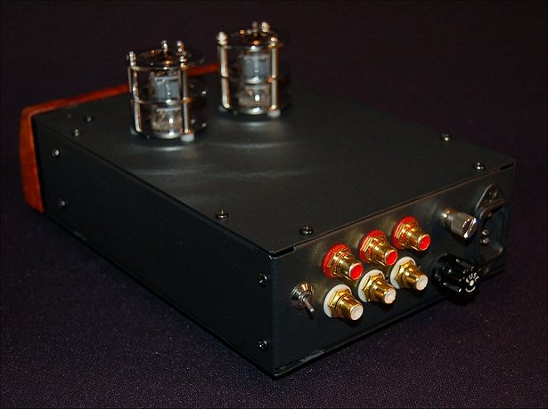

Here is another version I did that uses Amboyna Burl.

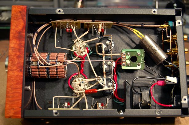

And inside I used a stereo 23 step attenuator with 1% Dale resistors. I also added the Bottlehead Anticipation upgrade and some Gudeman 1.5uF in place of the stock 2.0uf output caps.
