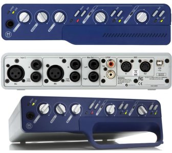

I'm currently using the mbox 2 for recording purposes (of which I have tried to attach an image).
could I use this as a dac alongside the crack?  would I need a dac at all?
I'm using my MacBook pro as the source, and i'm a little unsure on the routing needed to get the best out of my situation.

You should get good performance out of the computer/sound card into the Crack.  Sometimes, USB power can add some noise into the equation, so you may end up looking around for a different sound car with a wall wart power supply if you end up with this issue.  Often times, this can also be solved by using the laptop without the AC adapter.
Hi Gav, UK Crack owner here and I can confirm the 240v Crack works a treat. In terms of audio source most modern Macbook Pro's should be good sources even over an analogue 3.5mm to RCA analogue cable. If you plump for a DAC (I went with the Schiit Bifrost) its worth remembering that your Macbook Pro 3.5mm socket also doubles as a toslink optical out so you would have the option to use toslink or USB to drive the DAC.
As a Mac user it is also worth considering the Airport Express. Historically a controversial choice, particularly for analogue, but the latest model apparently lets you send it lossless audio that it can output as a pure optical signal to a DAC (same 3.5mm connection as your Macbook Pro that does analogue and toslink) however the latest model has had some decent reviews for the quality of its analogue out and you can pick them up on ebay for around £50 used and simply send the music to it wirelessly using Airplay. I am considering it as an option to add an easy to use Airplay source to my setup. Take a look at Ken Rockwell's review here:
