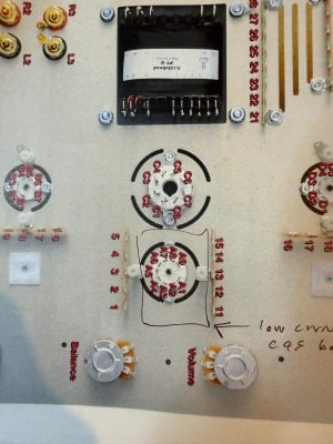

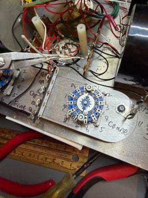

Hi All Im working on the TwoQuiet indtall and came across sonething strange. On the manual page 16 step 2 “”white wire from 7L … to Q7-L” I have a white wire from 12-L rhs under the low current c4s board pots to the front. 7L is under the lhs high current / voltage c4s board. Doesnt make sense - have requested an updated circuit diagram. My suspicion is that somewhere invtge c2a history the numbering of the terminal strips in the manual changed - my kit was from when the c2a was first released - could this please be confirmed?

Yes, the wire from 12 is the one you want to use. No, the numbering convention has never changed, it's just that nobody has noticed this error in the manual in the decade that the kit has been out.
