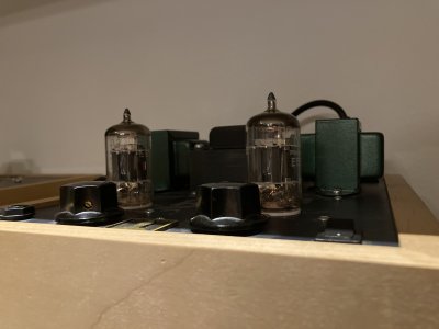

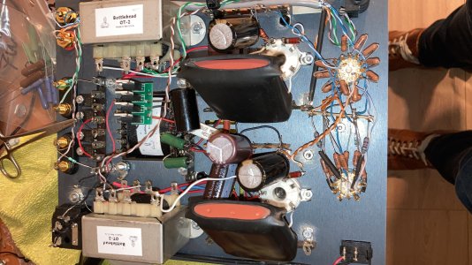

My first steps into the X of eXperimentation led me to this.
Inspired by the Mainline spud headphone amplifier; I rebuild my S3X with E55L tubes (triode connected).
See here: https://frank.pocnet.net/sheets/009/e/E55L.pdf
It's a very popular tube to use as a spud, with a large following in France.
It works like a charm on the first try! Only missing some bass (OPT's now wired for only 2 Ohm, need to change this). And i still need to check it with a scope (also to double check for oscillation).

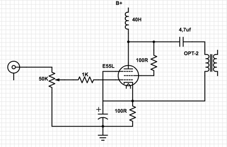

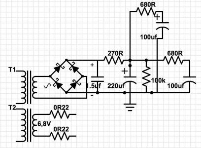

For those interested. I've tried my hand at a schematic.
Any suggestions (by the BH crew) for improvements for this amplifier? Do let me know!

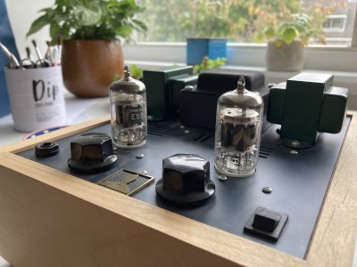

I started with the a very basic setup as a first try.
With the HD800's it's perfectly silent and has adequate power (even from the 2Ohm tap); a perfect single watt.

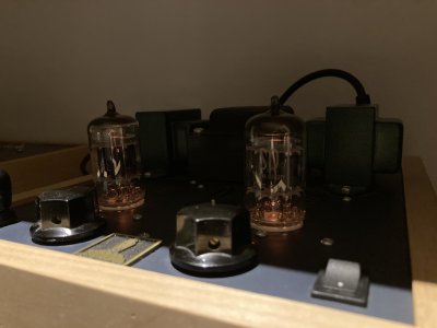

I enjoy it a lot! Here it is with Mullard Mitcham factory E55L's. I prefer these over the Amperex USA build E55L's for now.
Those are the only two plants for E55L I know about. That's it for tube rolling...
