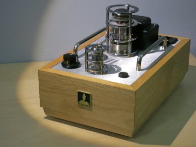

I've purchased the Crack kit long ago in 2011. Then I have spent some time making the wooden cabinet, purchasing some additional parts etc. Then the project "died" for a good while, because of the house under construction, kids & family and so on... However, the last Christmas I've been kicked out for few days of holiday from my job, which was very good thing indeed! I needed two evenings to accomplish the "basic" Crack and then two more for Speedball and final adjustments.
Customization

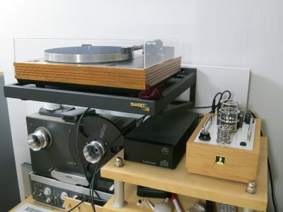

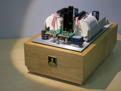

There are few things that I've made in a slightly different way, these can be seen at the pictures.
1. The cabinet is routed to match the look of my Linn Sondek LP12 record player.

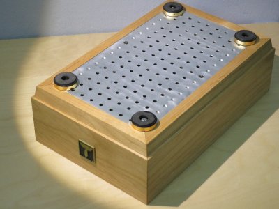

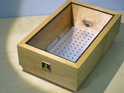

2. I added a vented a bottom cover to which the feet are attached, occasionally bought off eBay.
3. Added two handles, for more easily lifting the chassis. Underneath the handles two aluminum profiles are mounted in the same sweep to hold the output capacitors.
4. Added the tube guards. When I started the project, my kids were small. The idea was to keep them out from touching tubes of pure curiosity. When finishing the Crack the kids were old enough to understand, but I added the guards anyway, mainly for the look, but they showed to be very useful to protect the tubes when working with the amp "upside down"
5. The Alps Blue pot
6. Mundorf M-caps 100muF (large like beer cans) crossed with Mundorf Supreme 0.1muF
7. The black trim around the top of the chassis is self-adhesive felt, sometimes used for light sealing in vintage film cameras (my second hobby...) This is to provide "softer" and more dampened fit.
Looking back, I do not think the custom volume pot or the capacitors have contributed much to the sound quality, but they slow down the work for sure - you order one thing and wait for it, then you order another, wait again and so forth.
The learning from this project is this: I will build the next Bottlehead kit as is, just out of the box. It will surely save me few bucks and a lot of time, which I can enjoy listening to music. The standard kit already features VERY good component selection.

I've experienced no troubles assembling the Crack, thanks to excellently written manual. The Crack started at first kick, both basic and Speedball, of course after the resistance and voltage checks.
Lately, I discovered that the 6080 Philips tube from the kit was slightly microphonic. It made "scrambling" sound in the headphones when gently knocking on the tube with a nail. Later I noticed a clear level difference between the right and the left channels. Changing this tube to a NOS Sylvania 6080WB solved the problem.
Another thing that confuses me a bit is the power transformer which is getting HOT. For a "solid state" guy, hot means 120-140F/50-60C. Is this normal???

Excellent craftsmanship! I especially like the tube cages. I've always liked that look but for some reason I never tried it.
Thanks Alexei, what a nice review! I think your observations about tube vs SS are spot on and your kit looks just lovely. I've seen hundreds of kit completions over the years and somehow that one just presses a lot of the right buttons for me.
Very nicely done, all the mods look great. Increasing the size of the holes in your base x 2 or x 3 might reduce the PT temps but no guarantee. You could leave the outer runs of holes the original size. Slightly taller feet or maybe an extra washer with these might also help. Nice Linn, looks like an Ittock too. I have a black one with an Linn Basic Plus (Ortofon MC10).
Power transformer temperature is fine, I'm sure. They are designed to run very warm.

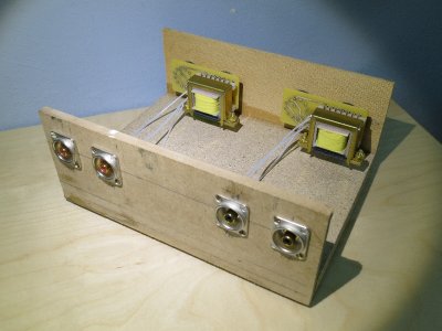

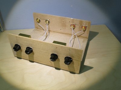

To give you a correct picture, not all of my gear is looking like the latest Crack, actually. Take a good look at my daily use passive "pre-amplifier", or more correctly, an autoformer based volume control. This thing was accomplished just in an hour or two, including the design phase. It's made for many years ago, and it is still in the same shape (notice Neutrik RCA connectors, though). The autoformer modules by Dave Slagle (aka intactaudio) turned my life upside down (before Crack, that is to say). I never thought the music can be so rich, so open, so powerful, so exciting before I listened to these. The sound is just RIGHT, but it won't push many buttons, would it ;) ? My multi-$k preamp went out for sales next day after I acquired autoformers.
Deluk: thanks! It's an Ekos Mark 1, actually. A close frend of mine used to work at local Linn dealership and he got paid with Linn stuff sometimes  :( . When he migrated to US I took over his Sondek for an exchange. It had an Ekos and K18-II. Upgraded later with Cirkus, Trampo, Lingo and whatever the names their marketing brownies concoct. Now with Denon DL-103R, the cheapest MC I've ever had and far better than all "Linnish" crap to cartridges I've heard before. Orto is a decent one, I want to try it some day. Need to worn out the 103R first ;)
