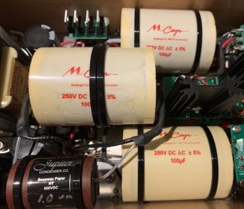

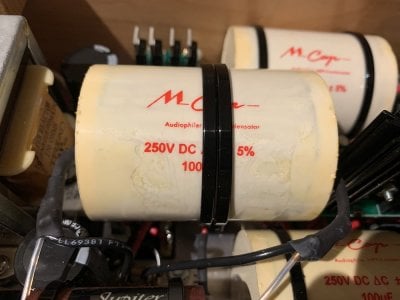

So, back to today: before turning it on, I decided to flip the amp over and have a look. The first thing I noticed is that in the 8 or 9 years since I last used it, the Mundorf film caps I installed have yellowed a lot. Is this just normal age related yellowing of the plastic covering rather than deterioration? The one that looks a bit funky is the central film cap that I used to replace the last electrolytic cap in the power supply, but again maybe it's just yellowing of the outer layers and the glue that holds the outer layer together?
I added a few photos below. The last photo is what they looked like during the build and modifications in 2016.

Yes, plastic can yellow as it ages.
I've done plenty of repairs on tube gear with those white Mundorfs where they have yellowed a bit over the years, that's not super abnormal.
