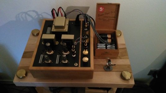

Finished up the Seductor, all the resistance and voltages passed within tolerance so I fired it up. Makes music and no strange noises, dead quiet off the Quickie, just like the Quickie>S.E.X. I've been listening to for the past couple of weeks.
There is however a pretty noticeable channel imbalance. With the S.E.X., the balance pot on the modded Quickie would hover right around 12 o'clock, give or take with the ambient noise. The Seductor takes a setting of almost 3 o'clock to bring the right channel up.
I swapped tubes but there was no change. I'll post voltages later, too late to write 'em down last night. I'll also check the D cell voltages, I have been running it quite a bit.

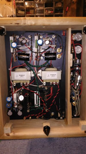

I still haven't found the secret of photogenic wiring, but here's a peek under the skirt anyway.

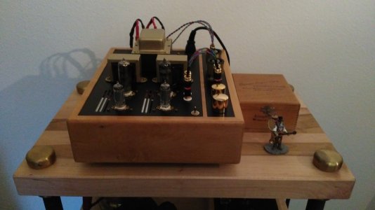

The Seductor feeds a pair of Frugel-Horn Mk 3s with Alpair 7 drivers. The system has enough bass, corner loaded, that I don't feel the need for a sub.
