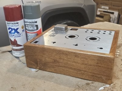

Hi All,
I'll start a thread for my build progress and questions along the way. Just getting started. Stain just applied to the base.
