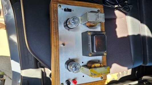

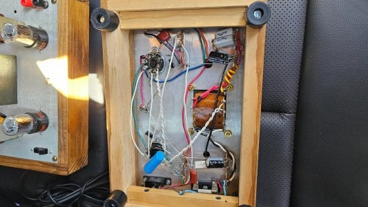

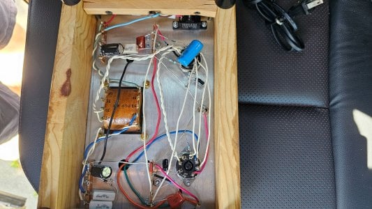

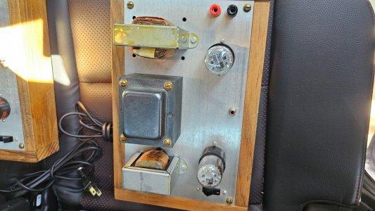

Today, I purchased what I believe to be 2 early bottlehead mono amps. Tubes are 3 Dumont and 1 GE 6dn7s. Powered both on ..tubes light up. However after about 5 minutes or so the left side caps on both popped. Is this due to old caps..possibly a couple of bad tubes. Any insight would be helpful...Obvious newby. Thanks.

That looks like a pair of original S.E.X. amps, with the excellent Magnequest PGPp8.1 power transformer. It probably dates from 1997, a few years before Electronic Tonalities became Bottlehead. Quite a historic find!

They are a neat piece of the Bottlehead story and could certainly be made to work, but those original output transformers weren't quite up to the task at hand, so they are somewhat prone to combustion. The traditional remedy for this was fitting the TFA-204. You could likely fit the current SEX iron upgrade onto these to get around that issue as well.
I'm certainly willing to fix them up for you if you want them taken care of, but it's a slippery slope when you'd really want thicker chassis plates, IEC power cord plugs, etc. I do think there would be people online who would pay $300-500 for that pair in unknown working condition.
For the record, it was the power transformer that would let out the magic smoke ... :^P Dan commisioned a replacement which went into the kit a few months after the first offering. A year or two later we switched to the Magnequest PGP-8.1
The output transformer just rolled off early and needed the feedback to fix that problem. Both transformers were sourced from a surplus store, which made the kit very affordable.
