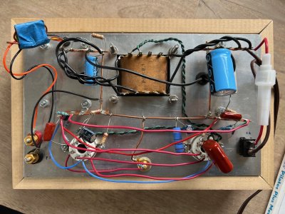

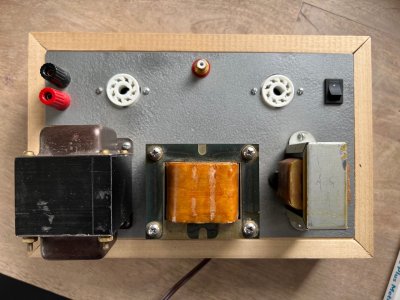

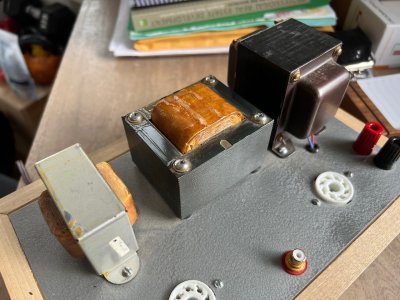

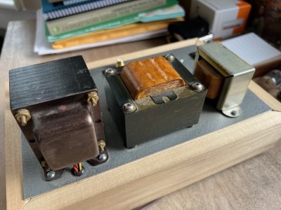

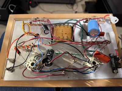

Thanks for your words of encouragement. Some photos of what I have attached.
Excellent - you have the parts I hoped you had.
The main issue is that the PGP8.1 power transformer makes more voltage than the previous power transformers, leading to excessive plate dissipation in the output tubes and reducing the lifetime of the filter capacitors. Here are the essential changes, relative to the Rev 2.0 manual:
1) The 10uF/450v electrolytic filter caps should be replaced with some rated 500v or more. They are harder to find but do exist. I would recommend higher capacitance values, such as 22 or 47uF, as long as they fit. Get 6 of them (see note 3).
2) There is a 1000 ohm 5 watt resistor between power supply and the output transformer (terminal 6 to terminal 14; p.23 in the manual). Replace it with a 1000 ohm 10 watt resistor - the original is under-rated. This resistor gets hot, so don't let it touch any adjacent electrolytics!
3) Install the third 500v electrolytic filter capacitor with the negative to terminal 13 (a ground) and positive to terminal 14.
4) There is a 270-ohm 1-watt resistor between B3 and the ground bus (p. 23 bottom). Replace with 330-ohm 5 watts - the original is badly underrated.
5) The resistor in 4) is bypassed with a 100uF/16velectrolytic  capacitor. Replace this with 100uF/35volts.
6) Be sure to skip the two instructions (p.24 6th instruction and p.25 3rd instruction) as noted for the TFA-204. This removes the feedback/treble boost circuit that is only needed with the old stock output transformer.
These changes will make the amps more reliable and better matched to the TFA-204, while making as few changes as possible from the manual. It should sound quite good!
Both PB and I have a fondness for these old designs, and we'll be available to help if you have questions. (If you should change your mind and just want someone to make them work for you, PB does excellent work, and would probably add a few more good tweaks!)

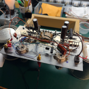

The years have passed. My older daughter graduated college with distinction. The basement shop flooded. Progress on ye olde SEX amp moved slowly. And yet here we are today:
It lives! Or one of them does, anyway.
Thank you for your tips and guidance.
