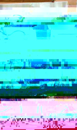

Earlier this year I resolved to build a "vintage" "American" stereo system based on a pair of JBL 4311B speakers that I had always wanted.  The hardest component to source was going to be the preamp and I looked at a few vintage tube preamps.  Finally one of the guys on the JBL forum proposed that I buy his new in box Foreplay kit from 10 years ago that he had never put together.  Problem solved!
It had all the instructions, Anticipation upgrade and no wooden box.  So, here's what I came up with: (hope the pics post!)
The inside, lacks the geometrical precision of some kit builders I've seen on these shores, but it works great!  Actually, when I first fired it up one of the RCA tubes was bad but I was able to source another one and it's quiet as a mouse....noisewise anyway.

Sorry for the double pic.  I should add that I used advice from this forum on shielding.  I built all the cables using Canare Star Quad 4E6 cable, connecting the foil shield on the outbound signal side only.  I grounded all the chassis in a daisy chain all the way to the outlet.  Very low noise.

Innovative and well done!  I really like what you did with the case.
How did you get the metal-work done?  Do you have a break and bender in your garage?

I can't take any credit for the case.  I do have access to a break and bender but this was just something off the shelf at Fry's Electronics that just happened to have the perfect dimensions.
