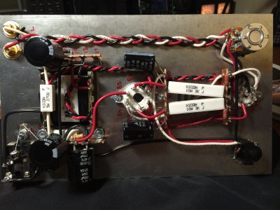

Nice job like how you have left the caps on long leads that will make fitting the speedball later a breeze
I'm impressed with the braid and the twisted pair for the heaters.  Very regular intervals.
The soldering looks nice and shiny as well.
Thanks for the kind words all, I am pleased with the way the build turned out.
It has been 20+ years since I picked up a soldering iron. I learnt quickly that that my eyesight is not what it once was! I also have a lot more patience than I did 20+ years ago which certainly helped towards a successful build.
I built this with the Speedball upgrade in mind so where possible I made things easier for when that happens. Sooner than later :-)
Thanks again.

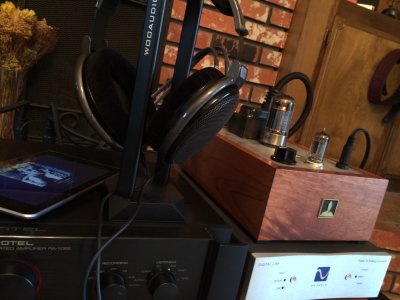

denti alligator said:
Yep, Rain Dogs is a great record for testing the sound. Nice choice! Are you using J.River with J.Remote? What DAC do you have?
Tom and I go way back (metaphorically speaking) ;-)
What you eye with the ''Rain Dogs album art displayed is a Nexus 7 tablet running the Sonos app. Besides various Sonos Play 5's littered throughout the house I have a Sonos Connect with SPDIF Coaxial out to to a PS Audio DLIII DAC. Just staring to experiment with Hi-Res audio and for that I use a MacBook Pro with iTunes/Bitperfect and an Audioquest Dragonfly DAC. 'Bad As Me' is great at 96/24, Tom sounds extra gravely, in a very good way.
WJ

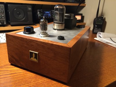

WK3K said:
Really like the stain on your base - what did you use?
Witold
Thanks. I used Minwax Cherry 235, two applications since just one was a little too light for my liking. I did use Minwax Pre-Stain prior and finished off with 3 coats of Minwax clear semi-gloss poly.
WJ
