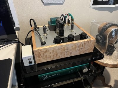

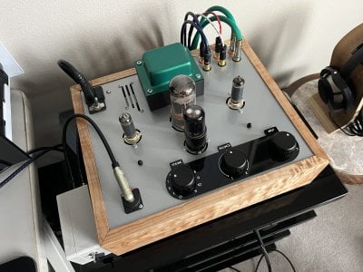

I've padded an Alps pot for a Crack build before, but is the 75K/33K resistor padding the same for a Crackatwoa? Because the C2a already has resistors going to the volume pot. So, how would the padding be wired up in this case? Like the title says, I'd like to be able to get closer to 11 on my volume range! Right now, I never have to go past 5 with even my various 600-Ohm AKGs. Any guidance would be appreciated. Thanks so much!

You could move the resistive pad to between the selector switch and the balance pot, but it'll sure look a lot different than it would on the volume pot. Given that you have a balance pot, one of the larger reasons to implement the pad in the first place is already resolved.

You would put the padding resistors between the balance pot and selector switch. The resistors between the volume pot and balance pot must remain in the same position.
