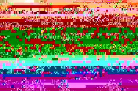

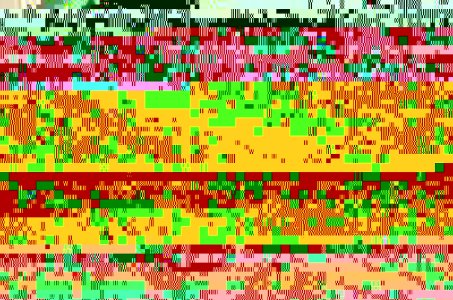

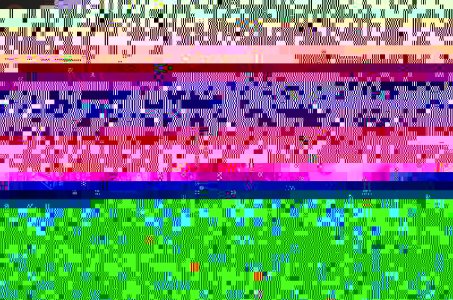

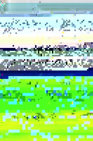

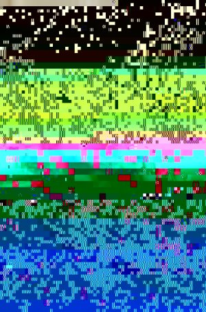

Hi folks,
Here are some pictures of my Stereomour, built at the end of last year, and slightly upgraded following some of the forum's recommandations :
1) Alps "Blue Velvet" pot
2) Russian FT-3 0.1uF caps
3) Jantzen Z-Superior 3.3uF parafeed caps
4) Triad C7-x chockes in the power stage (replacing the 360R and 1R200 resistors)
Sounds beautiful. I get very low hum, around 1.3 mV. I replaced the noisy stock 12at7 tube with a quieter psvane.
